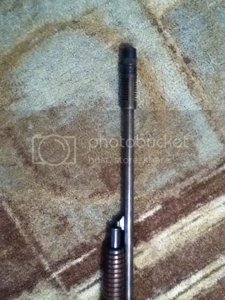

I have a shotgun that was given to me by my dad, it was my Grandpa's. It is a Stevens 820b, so it's not really worth anything except for it's sentimental value. it has a poly-choke type thing on the end of it, but someone screwed it down tight, and left it for years most likely. Now anything looser than modified and the thing is likely to fall off. The gun looks to be in fine shape mechanically, the finish is a bit worse for wear. I am thinking about cutting the barrel down somewhere between 18.5 and 22, (where the choke starts) and make the gun into something handy to just have around. I may later try to find a longer barrel so I can use it for the occasional hunting trip or whatever.
So, here's my question, the is no rib on the shotgun, so could I cut it with a simple pipe cutter? one of those that clamps on and you spin it around while tightening it. If not, what do you suggest?
Should I just cut it to 18.5, or would you gain much by cutting it at 20, or 22?
The front bead is on the poly-choke, any idea what sight I could put on the barrel to replace it?

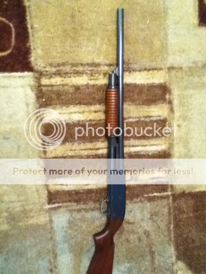

Well, once I got started I couldn't find a place to stop.... Knew I should have taken before pics.....
I cut the barrel, sanded it and the rest of the metal on the gun down and re-blued it. It used to have a nasty brown blue that was mostly gone anyway as well as a decent amount of rust.. Then I decided the wood needed some attention as well. So I sanded it to get rid of some of the light scratches and the nasty old finish, as well as some water damage. I am extremely pleased with the way it turned out. Now all I have to do is get a front bead put on.
My only before pic.
and the after pic
I didn't sand all the dents and scratches out, those were put in it by my Grandpa and my Dad and uncles. I love guns with history, and this one has plenty for me. Can't wait to get the springs I need to get it up and running.
