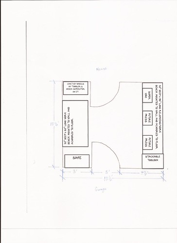

So I have this 10 1/2' X 10 1/2' room that I want to turn into the ultimate gun/reloading room. I have some ideas as to how to make it work but I figured y'all might have some ideas as well. Let me know what you think. I can put a safe in the room or elsewhere. I wouddl like your ideas on security, how to mount stuff, where to place it, etc, etc. Anything you can think of to make this room badass, safe, and very user friendly would be helpful. Heck I even want to know what type of ventilation system to use and what type of dog to get to guard the place.
Here is a rough drawing of the space.

The right side is how mine is now. The left side are future plans. A few things I had to redo/improve is have more light and table space than I thought I needed. Can't have too much of either
I can't read that picture its too small.
I really like that idea of 3 presses. 9mm, .40 S&W, and .223. How much space wouddl a guy need for 4 of them in a row. I need a .45/.308 press too.
no room to open the door on the safe
Safe door faces room door. May or may not work, depending on size of safe
4 presses...about 16'. Personally, I was going to have mine about 2' apart.
