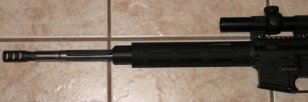

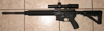

Just finished with it. Weight the whole thing again and it weight 9.2lbs with the scope. It feels a little heavier than my 16" carbine but not that bad. The hand guard is a YHM Customizable and it weight 12oz.

Yeah, you're right. It is a spector length tube. I thought it would cover the gas block a little bit more being 1inch longer than the mid length tube. Well, I might use this tube for my 16" and get a rifle length tube for the 18". Maybe a carbon fiber tube.

After I put a scope on it, it will be about 9.5 pounds. Is that too heavy for 3 gun competition.
Whether it's too heavy or not depends entirely on you. When I started getting serious about 3-gun/action rifle I found that I wanted basically the lightest rig I could make with a 20" barrel. If you are straining or getting fatigued by handling the rifle, you're not going to be relaxed enough to make good shots.
I strongly recommend that you start shooting matches before changing a single thing on your rifle. Your preferences will change a lot. Those DPMS barrels are nice, but there's about a pound of extra material on that barrel. My primary rifle has a 20" turned down to LW profile and the gun weighs less than most 16".
I have both the Clark and DPMS carbon fiber handguards. I like the design of the DPMS better even though the Clark is ever so slightly lighter. You're welcome to check them out at the March 3-gun match. I agree with Mike that you want the longest tube you can get. I'd have a 15" PRI if I wasn't such a cheap ass, but the 12" rifle length tubes are still great.

After taking the above rifle to OKCGC and ran some different drills, this rifle seem so heavy to me. It felt very sluggish going from target to target and my arms was burning only after a fews minutes.
Anyway, I decided to go a different route. Here is my new setup and this ran like a dream; light, fast and soft.
- Lilja-Nordic 16" 1/8 mid gas.
- Nordic Corvette Comp.
- JP adjustable gas block.
- Clark carbon fiber handguard.
