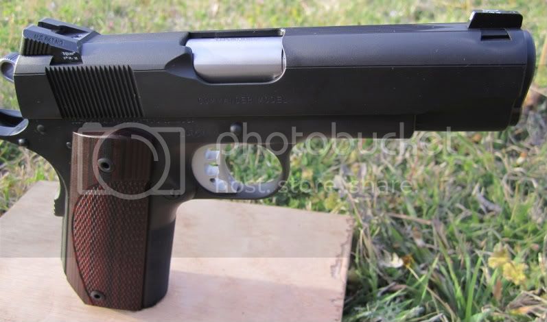

You need to talk to Mike about doing work on it. Just be warned, I took him my Colt with plans of just sights and trigger job and it went from this when I dropped it off
to this when I picked it up
