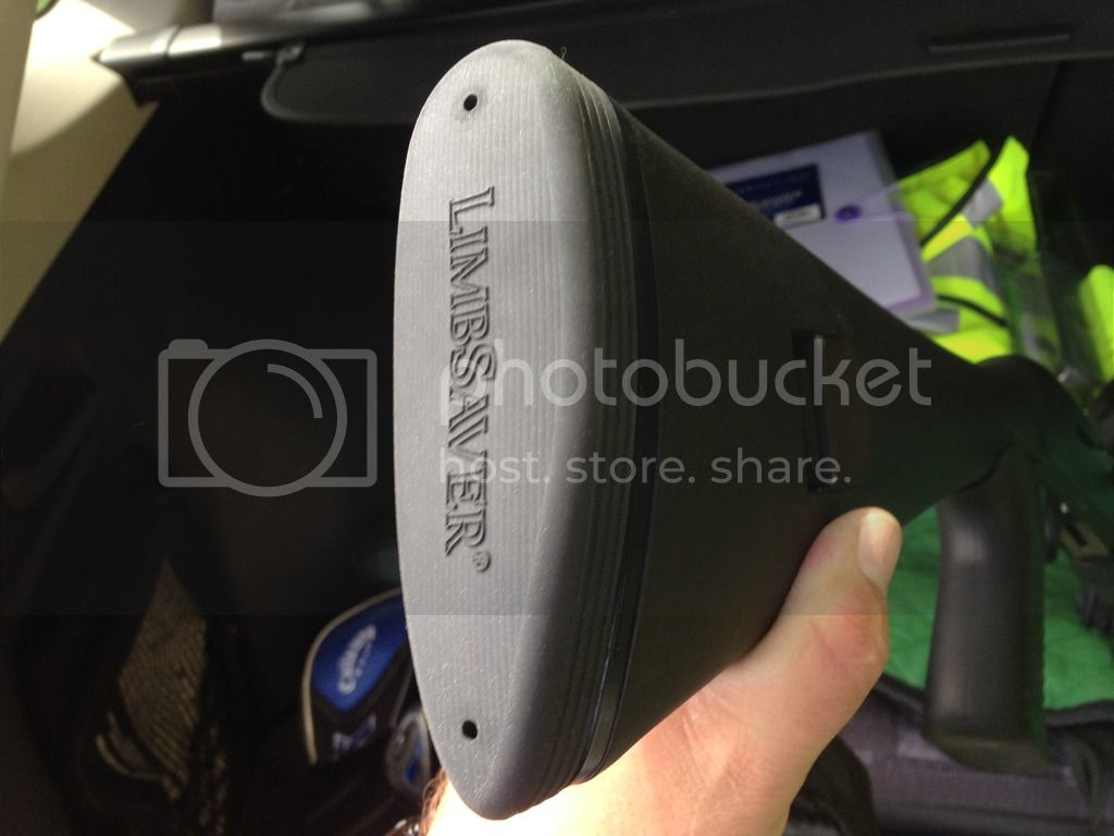

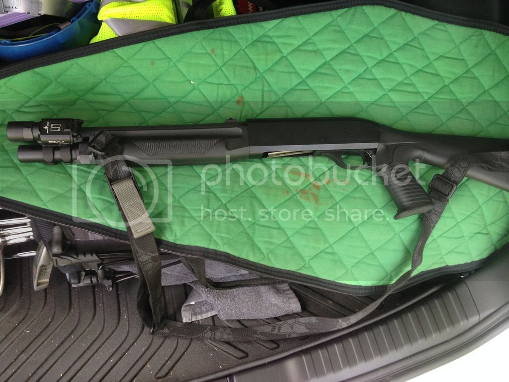

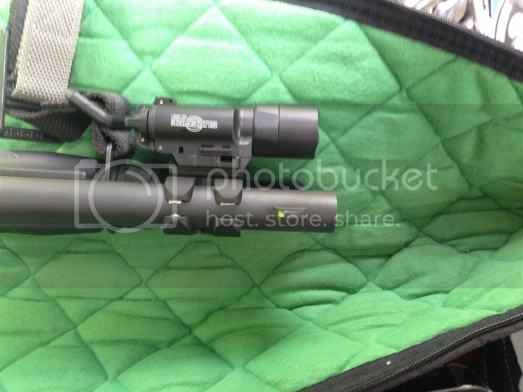

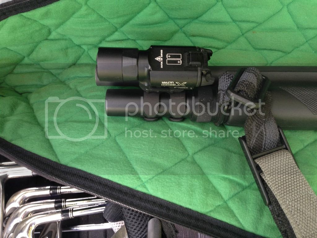

Well, I got the gun running. The Surefire forend was too heavy it seems. I went back to the stock forend and it runs 100% even with 1200 fps target loads (Remington Gun Club). LE1321B runs perfectly as well. Still wanting a light on the gun for HD, I got a Nordic clamp with rail and threw on an X300U. Everything still runs perfectly. Finally, I added a Limbsaver pad to make the gun a bit more pleasent to shoot - still no issues. At this point I'm pretty well set with it for function. Just need to get it on paper again and confirm zero with buck and slugs.
