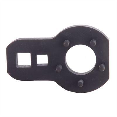

This is the barrel nut wrench I've got. I like it because it was small, and for a quality brand, low cost. My dislike is that it is a closed end wrench, so you have to remove the gas block to use it; even if you want to keep that gas block later.
PRI Barrel nut wrench @ Brownells
