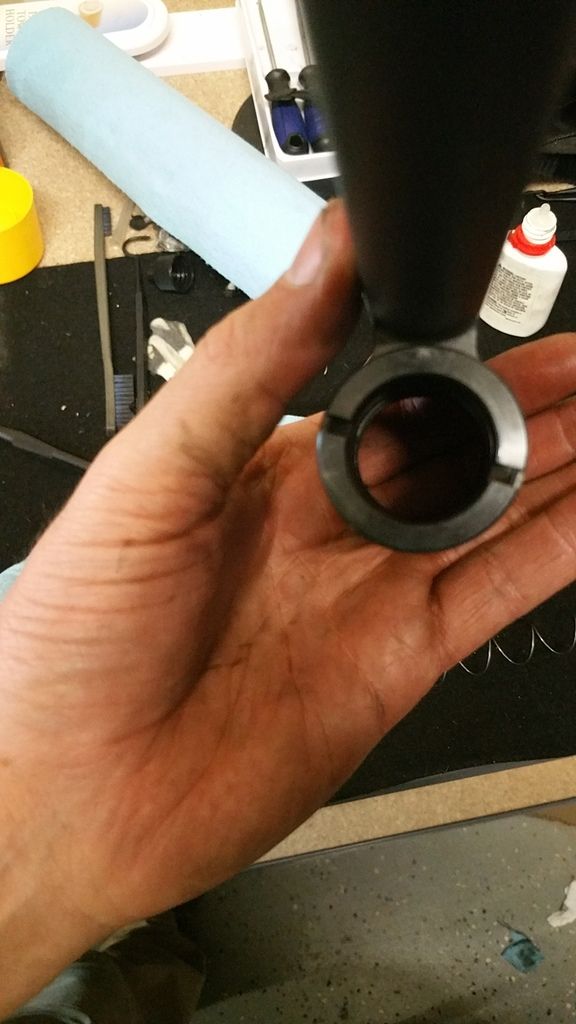

I have a brand new 930 with maybe 200rds through it. I took it apart to clean it but when I went to put it back together, i couldn't get the tube extension on with.
I saw that the forearm wasn't seated all the way because of this piece being rotated somehow. It won't allow the notches to line up. I have no idea how I did this or how to fix it. The dang thing won't budge.

Those notches don't need to line up with anything. Of the seven 930s in the shop, not a one has those notches on the same plane. Whatever you do, don't attempt to unscrew that piece as it is under a great deal of pressure by an internal spring and will not easily go back together after you return from the hospital. The notches you see are used for assembling the secondary gas system with a specialized tool. Here is a video you need to watch before doing anything else:
https://www.youtube.com/watch?v=QfqdygODl9k
If that assembly has started to unscrew itself you will need to get it tightened back up before running the gun again. It sounds like either your secondary gas system's ring has worked loose from the groove it belongs in or the assembly itself has started to back out. If it is backing out, a steel tool for replacing forearms on a Mossberg pump shotgun will work to tighten it. The plastic ones Magpul includes in their forearms won't usually hold up to the torque needed to tighten that assembly.
Do you have a side view picture of that assembly? The entire gas system less forearm will make it easy to diagnose what you have going on.
