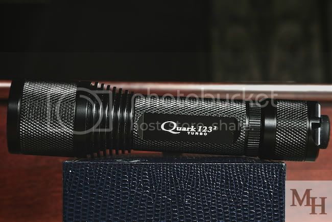

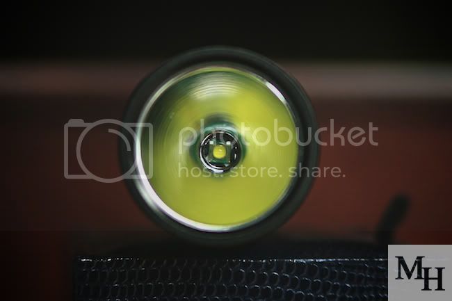

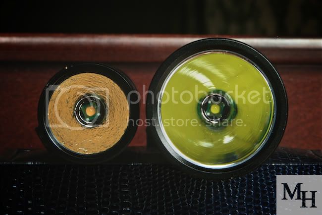

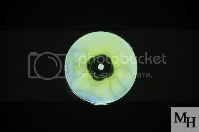

The body is anodized aluminum (type III), and features a deeper head than the regular Quark models. It has a smooth aluminum reflector in lieu of 4Sevens' traditional (and fantastic) orange peel. The LED is perfectly centered and the lens is high quality glass with anti-reflective coating.
Here is the smooth reflector next to a Quark 123² Tactical (warm white).

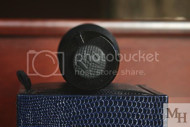

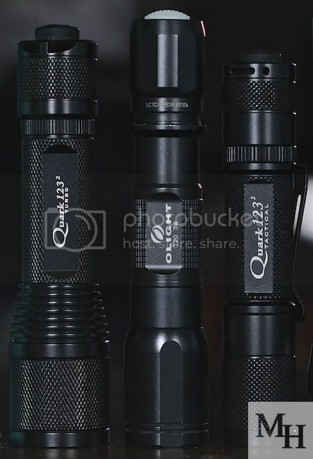

The light features a forward clicky (momentary on, full click for constant light), that is fairly stiff compared to my Olight T20. This isn't a surprise though, considering that this light was build with tactical situations in mind. Wouldn't want to accidentally actuate that switch with Nazi zombies bearing down on you, would you?

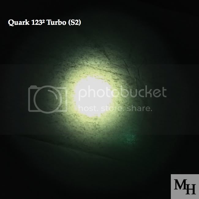

There's been a lot of talk in the flashlight community about the S2's green tint. It's still a very white light, but as you might have seen in my tint comparison post.
Here it is as compared to several other differently tinted lights.
As you can see, it's green. Oddly enough this doesn't detract from it being usable in everyday tasks (much like cheap LEDs' blue tint doesn't keep them from being useful). It's merely a matter of what's pleasing to the eyes.

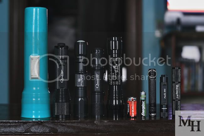

When my Turbo arrived I was taken aback by how darned small it is. The pictures of the light by itself make it look very big.
