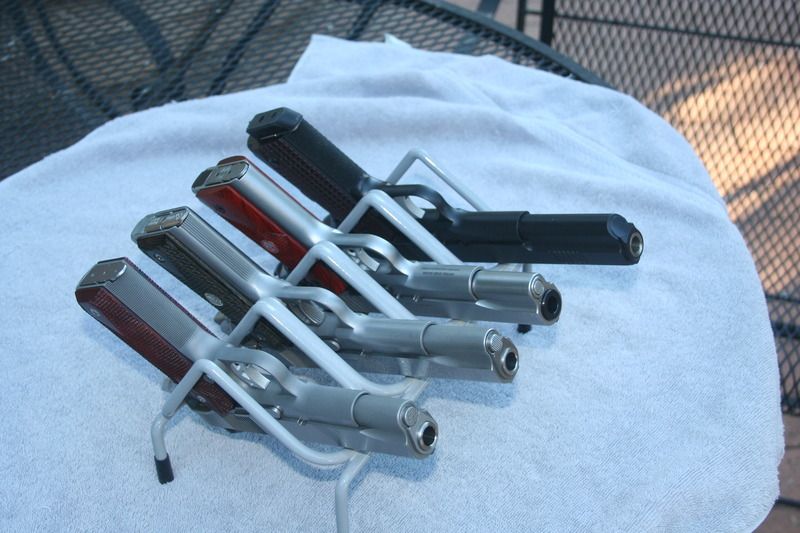

I would NEVER carry the Springfield because of the glued ejectors (which break reliably)
Given the choice of the two, I would carry the Delta IF it had been gone through completely by a gunsmith I trusted.
When I am carrying a 10 (in bear country) I carry a DL Sports, Dave Lauck / 2011. Absolutely reliable. Period663437AB-4EF0-441F-8C46-D65566C10846.jpegFABF54D2-6310-4C0A-9F0B-A973F40901F6.jpeg
