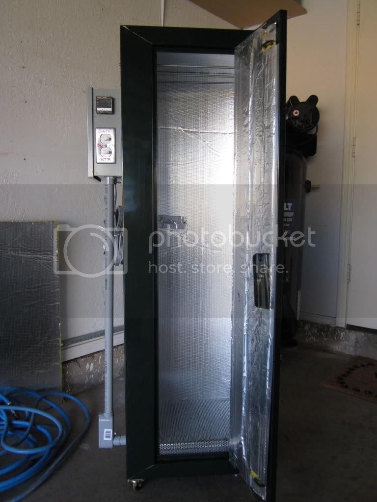

Alright, I decided a month or so back that I would like to mess with Cerakote, KG 3400, and a few of the other spray and bake finishes. Since I don't really want to use my kitchen oven, I thought a "paint curing oven" would be a fun project. With the help of my wife's dad, this is what I came up with. It did take several hours to complete and still has a few minor things that I want to add, but it's usable. I also got my vertical compressor ready to go and now just need to find a mid-size blasting cabinet. I may go with the stand-alone Harbor Freight model, but am hoping I will luck into something. Let me know what you think and feel free to ask questions.

Damm! You did a fine job of making an oven. I've never messed with the cerakote stuff, but do have to complement your handywork in getting a digital temperature control in there.
Does that require a type "e" or type "k" thermocouple?

It's actually type J, but you can use K. It also has some very pricey, though free, high temp wire connecting the element. The high-temp silicone I used to attach the insulation is awful and I may still be a little high! I'm going to run a bead around the seams too as soon as I get a chance. I also need to make some labels for the control. I'm really not digging the red Sharpie.

This is my kind of thread. What did you use for a heating element? Also, I've never seen a Love brand PID controller.

As soon as I get the blasting cabinet, I'd be happy to spray some stuff. I bought some cheap beat up stripped A2's the other day to learn on.
