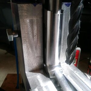

Perfect tool for cleaning small gun parts - my wife's sonic jewelry cleaner. I bought it for her 5 years ago and she never used it. Now its mine!
