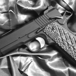

So I know a standard 1911 is designed for controlled feed 230gr ball. That being said my comp gun para P14 non ramped barrel feeds 152gr semi wad cutters. I fired 10k plus through the gun years ago running and running. Albeit it's a custom built gun just dated bit. Flash forward nearly three decades and I got an itch. Bought a RIA frame rando slide and a Wilson Combat drop in barrel. I had a local smith build it up for me with Wilson parts. It feeds one thing and one thing only. 230g ball. No truncated cone semi wad cutters or hollow points. It will occasionally feed hollow point but that's rare when it happens. Seems the gun fails to get into battery by about 16th of an inch or better. I took the slide off removed the barrel put the barrel on the frame with the slide stop pin pushed it all the way to the rear and I have 3/32nds from the back of the barrel to the frame ramp. Might this be the culprit? I've tried Wilson, Check Mate and a few other mags. I'd like to shoot something else besides 230's through it.
