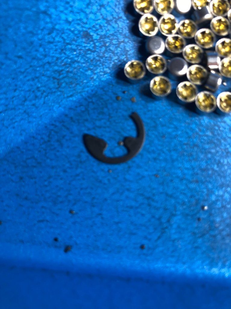

After looking more closely, the first die on the reloader says resizer in the tiniest print. That’s the same spot that de-priming happens. It’s also the same die where I learned about a “Jesus” clamp, see pic. That’s what the guys at the gun shop called it when we figured out what I needed when the reloader broke last week.

Rick Howell said:
Check out Ace hardware or Hone Depot and get some 1/4” stainless e-clip retaining rings.
Auto parts store as well

KellyB said:
... where I learned about a “Jesus” clamp... That’s what the guys at the gun shop called it when we figured out what I needed when the reloader broke last week.
It looks like as a "Mickey Mouse" clamp based on the above picture. What do people do to transfigure a Mickey?
I was told it was called a Jesus clip because when it snaps off either by breakage or in the process of trying to put it on, it is “Oh Jesus where did that clip fly off too.” Lol
