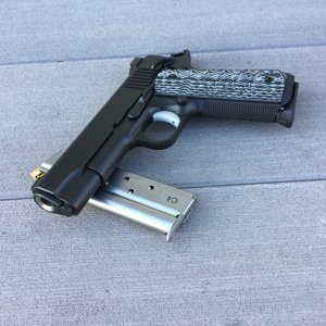

I had this on a watch list because I found it interesting.
I'm not familiar enough with comped 1911s to tell if that's a bushing compensator and there weren't any pics from the front to see how everything is put together. None of the pics showed a set screw or anything to suggest it's threaded onto the barrel.
What say ye?
