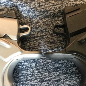

I already have parts to use on my GI kit. A Colt wide spur hammer, small shelf safety and a USGI arched mainspring housing with lanyard loop.

I didn’t take pics assembling the slide, not that many parts and went together easily. Only change that I made was swapped out the spring plug. The one with the kit was serrated (never seen that before) and I used a checkered one that I had.
Missed wiping off a little oil on the barrel bushing.
One thing about everything I have ever bought from Fusion, nothing will ever rust before delivery because they must use a quart of oil when they pack stuff up.
Slide to frame fit is snug. Same with barrel bushing. No play at all, didn’t need a bushing wrench, I could turn it in place using my thumb but it was tight.
