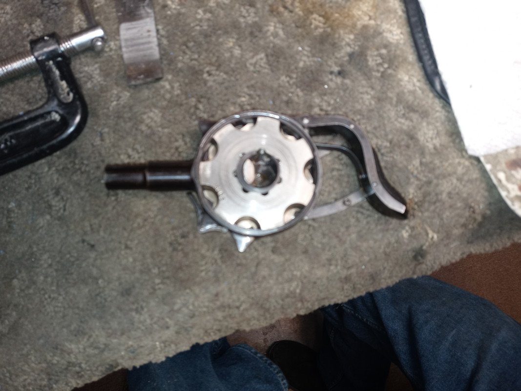

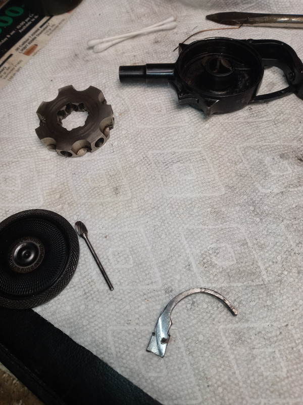

first pic is all the pieces:
the bottom piece , the C shaped metal, is the cracked spring..the new part being fabricated from the old part.
this is the cylinder..load rds from the inside, bullet facing outward"

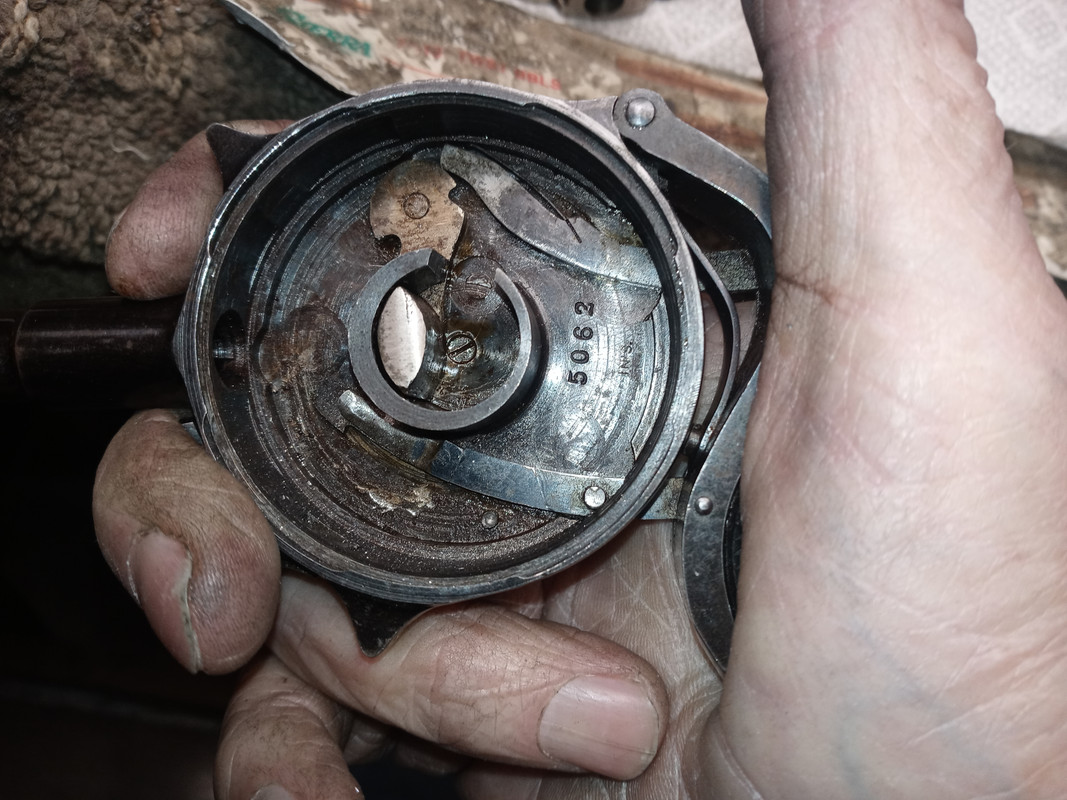

Here's the case: note the sear at the top..when the palm pressed the trigger, the sear move, then would break, firing fin ( attached to flat piece in center of frame) would rotate striking the cartridge rim & fire, the bullet would shoot out the barrel, visible between the index & middle fingers.

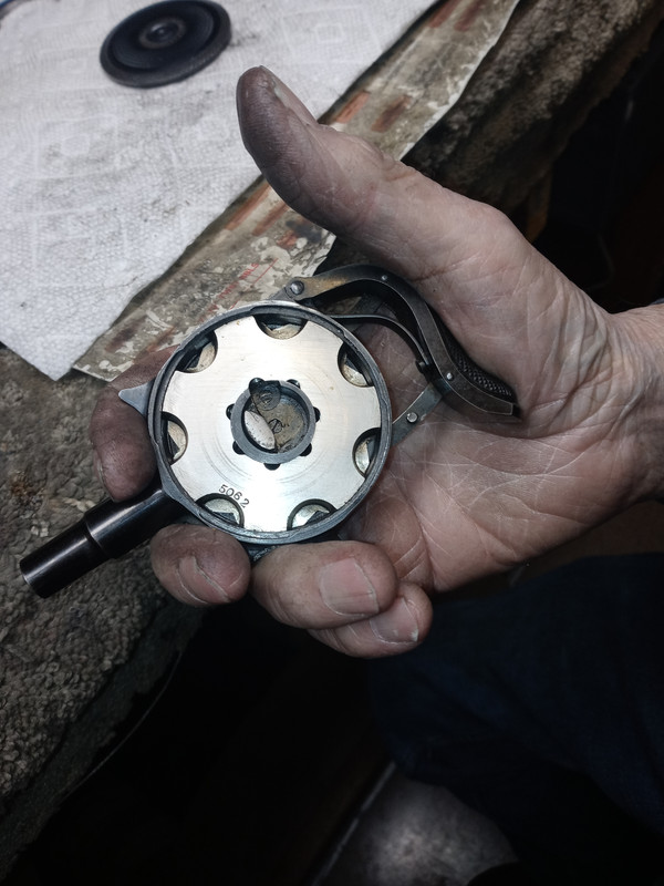

case with "cylinder " in place:

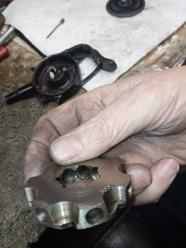

another pic of most the pieces in place..
I found the clever design & workmanship remarkable, esp. considering that it was made before 1900..
the inner workings reminded me of a mechanical watch. Ever tried to find 32 rimfire ammo ?
