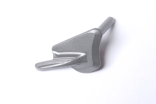

Being a thumb safety rider I tend to sometimes get "choked up" on the grip safety too much when drawing on the clock, especially in the summer when my hands get sticky during a match.
I just saw these for the first time, and ordered one. It will be interesting to see how it feels.

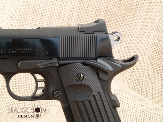

I like how the ergos look on that Harrison. I've got a Wilson Bulletproof wide paddle on my primary match blaster (Springfield) and the part literally dropped in with zero fitting. Who'da thunk it.
Anyway, I ordered the Wilson in the low ride iteration since hopefully it will drop right in as well. We'll see.

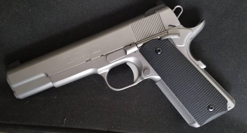

With the Wilson wide paddle Bulletproof safety still installed, and the new low ride safety held next to it.
IMG 1675

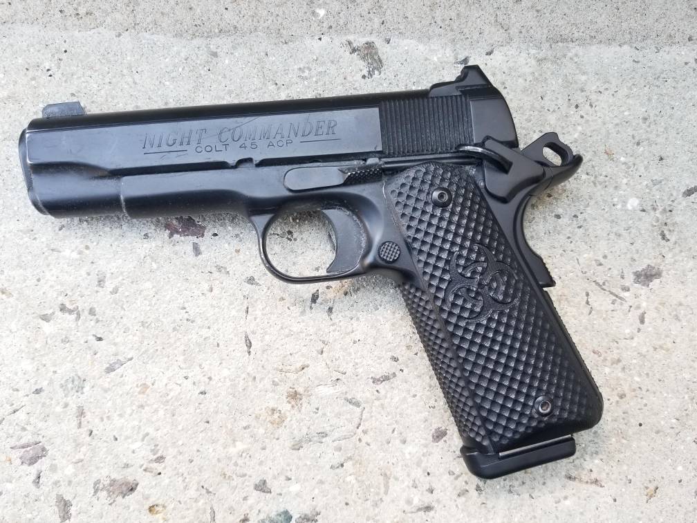

And installed on the stainless Springer below, next to a Colt with blued wide paddle Wilson Bulletproof (which is what I had in the Springer). Not as weird feeling as I thought it would be. I'll run it in the Buccaneer match Saturday.
Fullsizeoutput ae2
And it dropped right in, like it was custom fit to this gun, just like the one that was in it. Only happens with this Range Officer. They were both Bulletproof safeties, but it required a fair amount of fitting for the Colt and I'm still not totally happy with it, but it works. That might have something to do with the fact I cut the frame tangs and fit a beavertail to the Colt also.

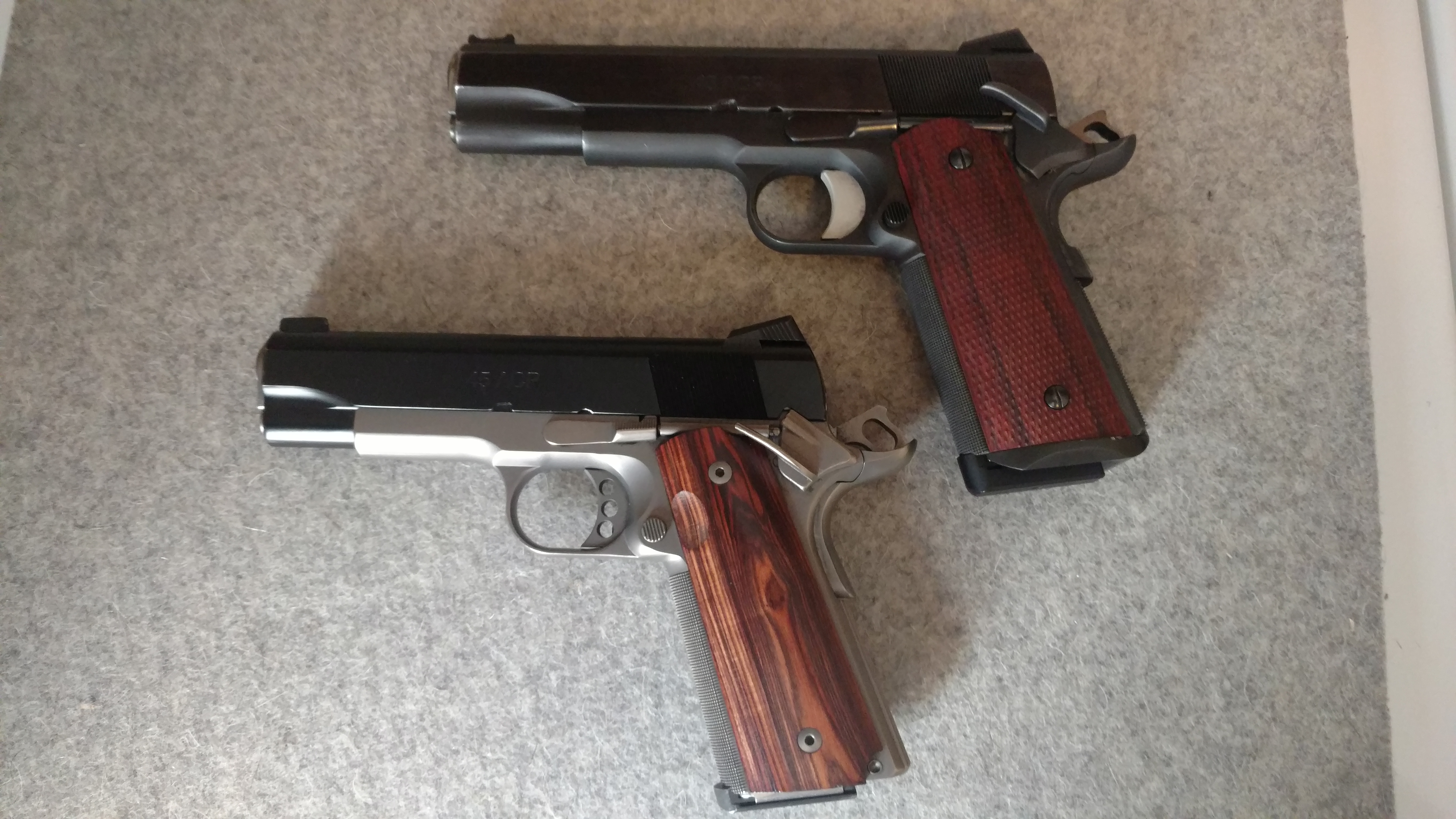

These are Grayson EGW lowered safeties. Very comfortable and the curved paddle allows my to get my thumb on top pointed straight ahead when firing. No holster issues.
I believe Joe used a Cylinder and Slide thumb safety on this one, and you'll notice it is in a similar position when off. Very comfortable as well.

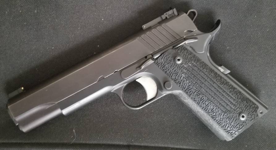

I liked the first Wilson low lever thumb safety so much I bought another and just finished fitting it in this Fusion. I had WC Armor Tuff coat it in black ($5) to match the matte finish of the gun, otherwise they come blued or stainless.

As for mods to the grip, none for the safety. VZ Operator II's
I did have to mod the grips for the Fusion extended slide release earlier (off screen). And the safety did require a fair amount of fitting, unlike the Range Officer where I think I just got lucky. (although that is the second BP thumb safety that dropped in the RO)
