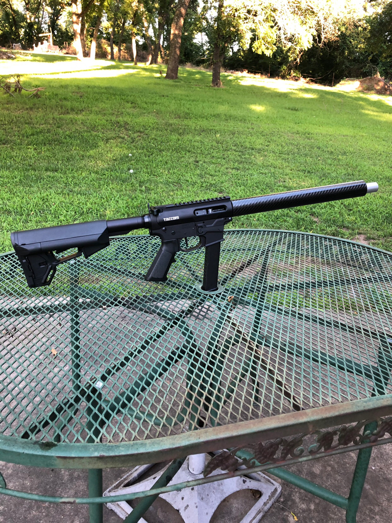

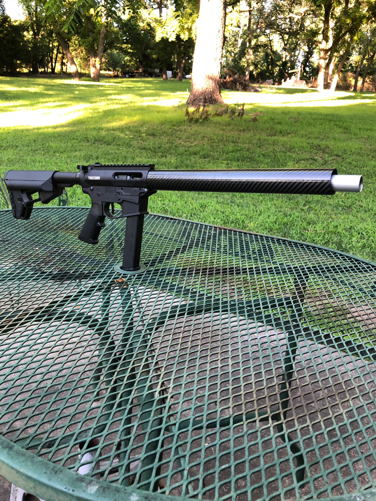

Been dragging my feet on this project, but finally got my 9mm Taccom upper out and finished the lower today.
Quarter Circle 10 billet stripped lower with a Magpul ACR buttstock, Timney 3lb straight trigger, and a three way Taccom carbine length adjustable buffer.
Put 10 rounds through it in the yard. Real soft recoil. I like it!
Now for the optics.
What is the hot ticket now for a red dot?
Primary arms has been pushing a vortex Venom on sale that I've almost pulled the trigger on but thought I'd check the shooting community to see what the cool kids are running.

What's interesting is that I was working on it tonight. For whatever reason, the bolt started jamming to the rear and staying there. I'd have to just easily bump the barrel to release whatever was holding it back, but it was a single shot. Found out I could really jam it into the shoulder and it would fire just fine.
I saw some wear marks on the back of the bolt and decided it had to be an out of spec buffer tube. Grabbed a spanner and started to remove the buffer nut. Moved it a tiny bit, and decided to test it.
Worked great! No more jamming. Dumped two hi cap mags in the berm in the back yard with zero issues.
Never heard of over torquing a buffer tube nut, but just releasing it a tad worked.
