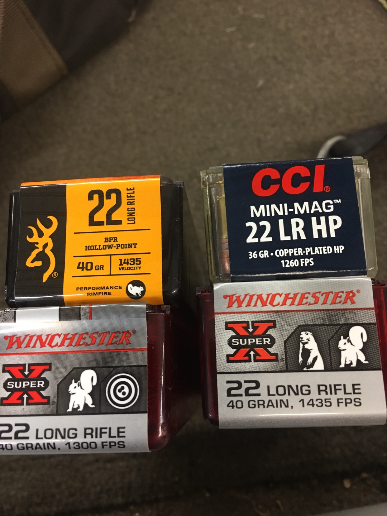

My Nordic NC-22 upper will run flawless with any ammo that runs 1260 fps or faster.
The 1200 fps CCI or other brands just doesn't seem to cycle the action fast enough. Just because I'm anal about it, I run the faster more expensive ammo. The cost over bulk isn't that much per match.

Dennis, if yours won't run 1100 fps ammo, you should look into a recoil spring change. Have you ever changed it in the 4 or so years you've owned it? It's probably due anyway.

I haven't changed the recoil spring since new. Probably time to do so. It will run the 1100 fps for the most part, but I can tell the difference in the action cycling. It's like I'm having to wait on it to cycle. The higher velocity stuff runs perfectly.
